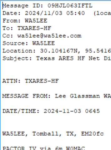

I just connected to Winlink - Telnet and got the following message.
I put TXARES-HF in the to box and when it is sent its converted to stx-ares@arrl.org and then refuses the message.
Please explain what the address needs to be so that I dont make the same mistake next Monday.

I have never seen that error before. TXARES-HF is a tactical address.

Jim et all,
TexasARES-HF is a “tactical” address. You might try sending your Vara-HF text to “Taxas_ARES_Net_HF” which VARA HF should translate to TexasARES_HF. If you are only using winlink telnet it will not work. You must use winlink with VARA HF.
My 2 cents, your opinion may vary
73 de K2WJ
Just to clear this up –
- TXARES-HF is a valid destination address. Regardless of mode, be it Telnet, VARA, PACTOR, Packet, etc..
- We get dozens of check-ins each week from all over Texas using that ‘tactical’ callsign.
- WL2K (WinLink) does not, under any circumstances, change the TO: line. Who you send it to is who Winlink sends it to.
- “Taxas_ARES_Net_HF” is not a valid Winlink address. Chances are it will go nowhere and/or bounce.
- Always Cc: your non-winlink email on everything you send. If YOU got it, THEY got it, unless you typed a bad TO: address.
- Of course SMTP:stx-ares@arrl.org got kicked back. That email address does not exist. (unless it is a placeholder created by the League to drop either to Stuart Wolfe, or a black hole on the server)
Suggestion: Perhaps it would be beneficial, since we have so many new ARES members on the net, to offer an online WinLink 101 tutorial training. If any of you are interested in such a training, please let me know and I will make it happen. Even a FEW classes to accommodate people with different availability.
We have a platform available to us that can take over your computer screen and walk you through the processes. (Securely)
I am a firm believer that Ham Radio folks acting in an AUXCOMM role will NEED to be familiar with Winlink and all its nuances. That is the system we will use to get messages (by whatever means!) from the outposts back to the served agencies when called upon to do so.
So, lets get this done and end the ambiguity!
