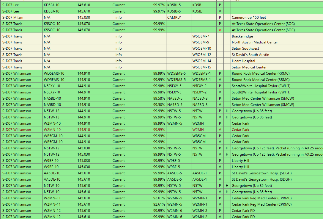

Hi Tom,
Can you suggest some VaraFM digipeaters in the Austin area, or where to find a list?
There is a digipeater column on the Texas RMS Status page here: PacStat Uptime Data (ecpi.com)
I copied a snippet of it below. For example, on the N5TW-12 RMS Vara FM station (the “M” column designates the mode and a V is a wide VaraFM station), N5TW-5 is the digipeater call. I don’t see any digipeaters listed for Travis K5SOC-10 may have one but none is listed.
Tom N5TW

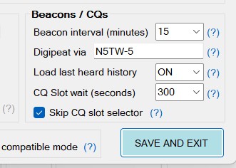

Thanks Tom.
I will try to experiment with VarAC on N5TW-5 on 145.030.
If anyone want to try to contact me I will keep VarAC running for a couple of hours.
I added N5TW-5 to “Digipeat via” under VaraAC Settings->Rig Control and VARA Configurations
In the past at least in the Houston area digipeaters on packet were -5 while the gateways were -10. With VARA FM the SSIDs have not been consistent, but most digipeaters are simply the same as the callsign+SSID. Mine is KD5YOU-10 for both gateway and digi callsigns.
I noticed that many digipeater callsigns are not listed on the Pacstat page, but either you can contact the gateway owner or just try something to see if it works.

And if SYSOPS send me their digipeater information, I will get that added to their status page listing.
Tom N5TW

I dobt see w5ktc-10 Vara FM gateway on the list. Do you need the info for your Page?
Mario
WO5O
Yes! Please send updates off list to me.
73 Tom N5TW
Its there in Calhoun county 8 entries below Williamson County. The “Notes” says there is a mismatch with the frequency.
