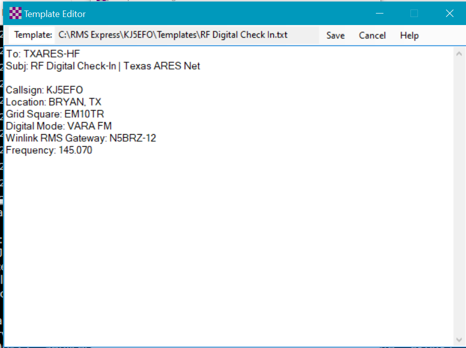

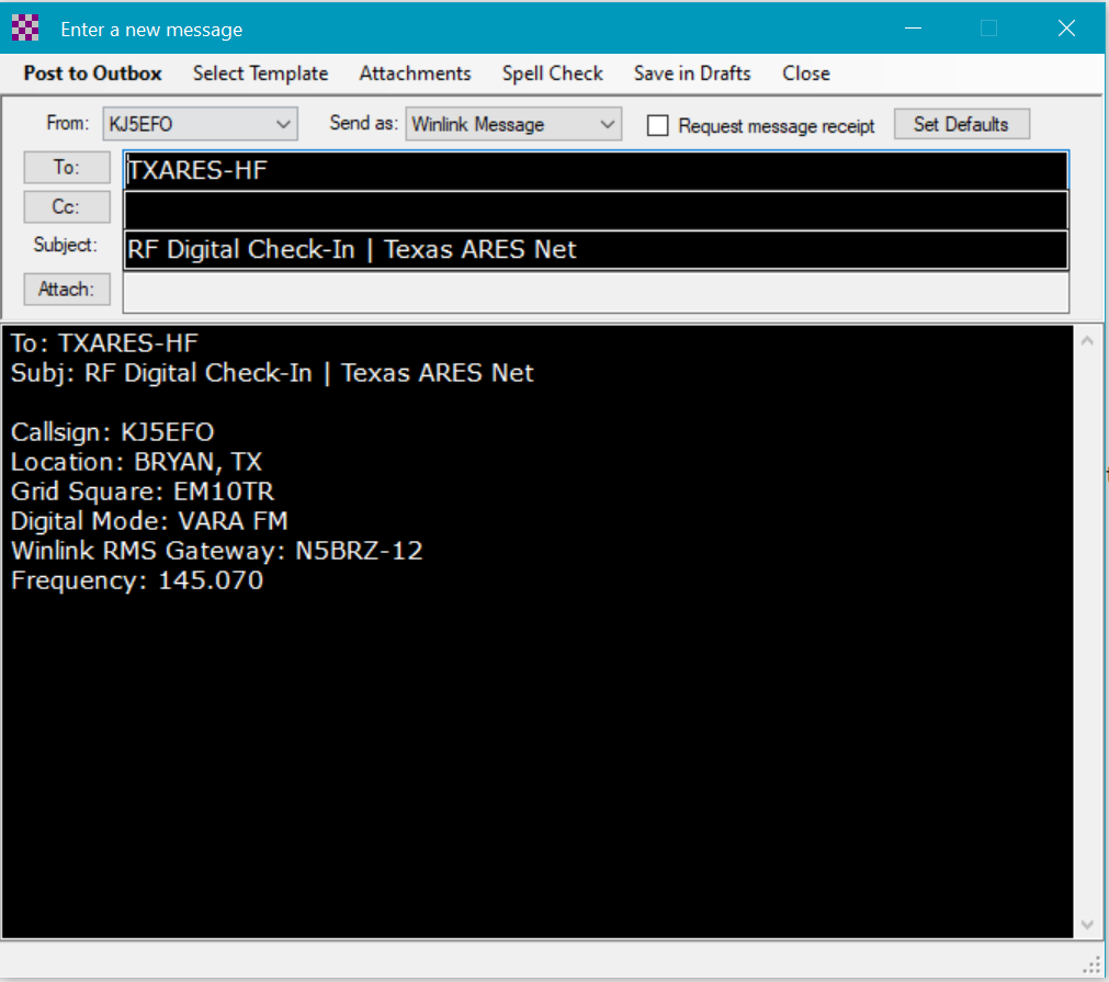

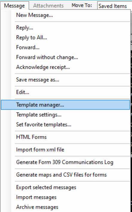

As it has been noted, there is not a standard template for the check in. If you are like I was at first, then you may be wondering “then what do I do?”. To try and help I will tell you what I do, and then folks can comment how it should be and we may get closer to an answer.
I send a message that contains the following:
Subj: RF Digital Check-In | Texas ARES Net
Callsign: KJ5EFO
Location: BRYAN, TX
Grid Square: EM10TR
Digital Mode: VARA FM
Winlink RMS Gateway: N5BRZ-12
Frequency: 145.070

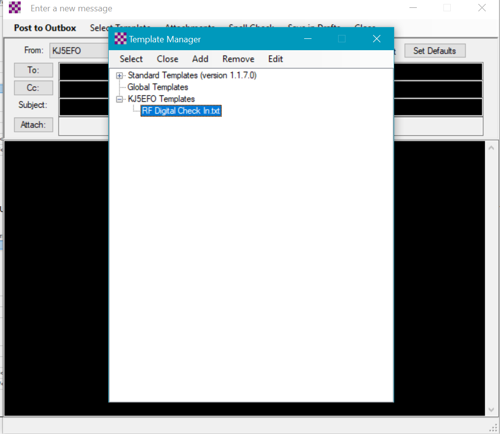

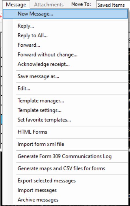

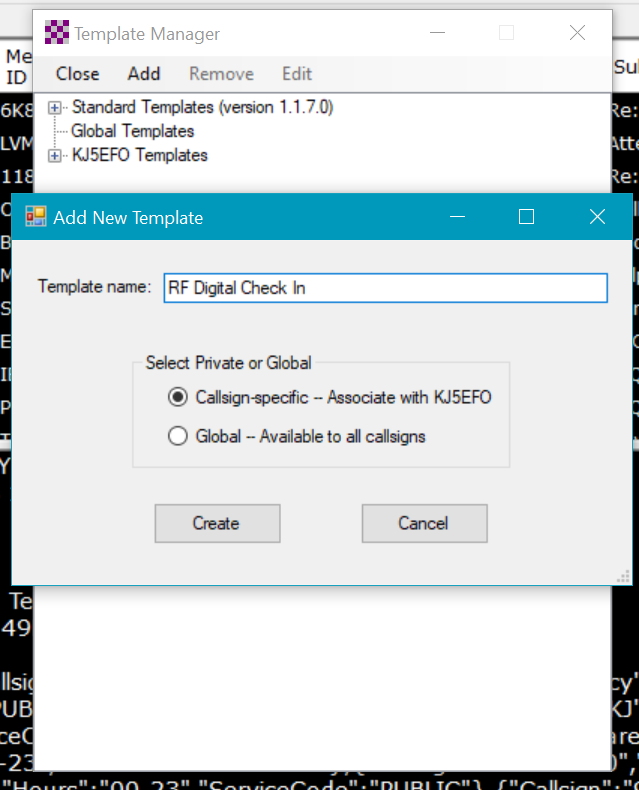

Obviously, change the information to reflect you and your information. I made this a message template in Winlink:
(Messages>Template Manager>Add>paste the above modified with your info>Save).
It is also possible to set up your own templates. For more information: https://winlink.org/content/create_your_own_templates_html
