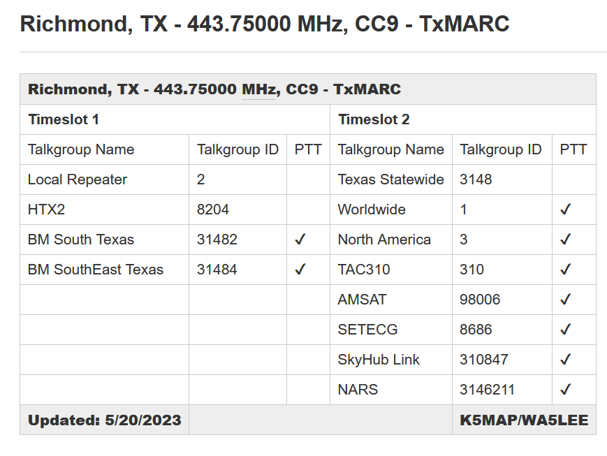

Unfortunately, 8686 (Southeast Texas Emergency Communication Group, AKA SETECG) is not reachable through Brandmeister or a Hotspot. It is only carried on certain Upper Gulf Coast repeaters through several cBridges, and can only be reached through a repeater that carries it. As you are (I believe) NW of the Capitol, there are no cBridges OR repeaters in your area that carry that TalkGroup.
If you want to see a list of all the DMR repeaters in the State, visit dmrtexas.net and click on ‘repeaters’, then select the region you wish to view.
Under each active repeater listing, it will show a grid (similar to below) that will show you what TG’s are carried:

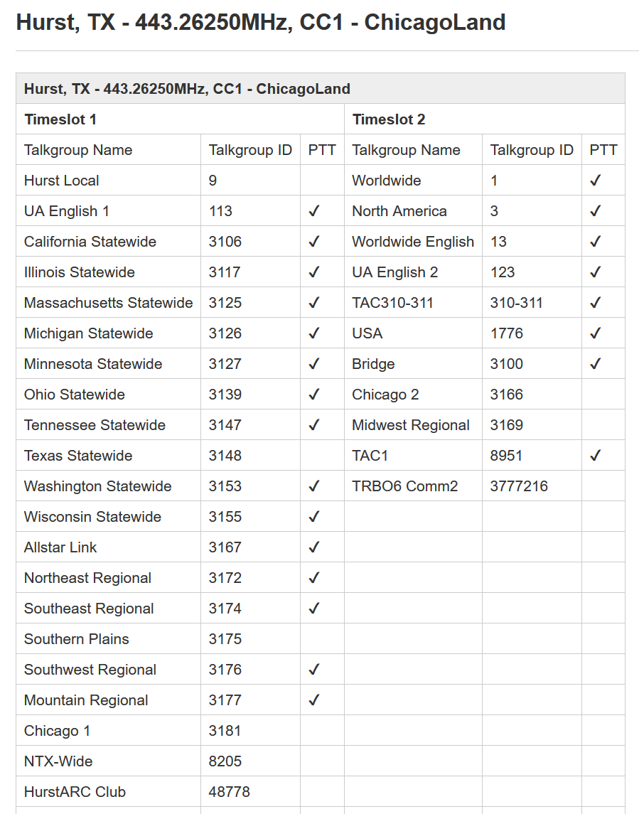

As opposed to:
Sorry to be the bearer of bad news…
